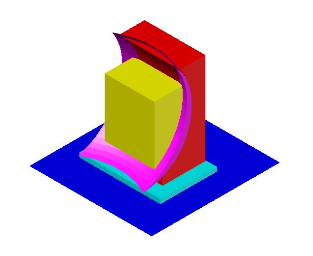

Making progress.

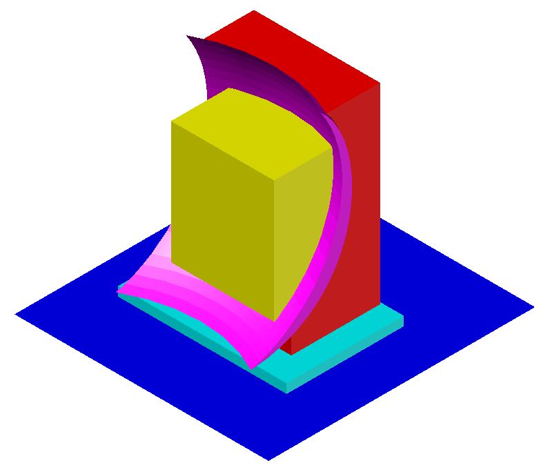

I created profiles of different shapes using polylines then used the LOFT command (with Guide option in two instances) to create the solids.

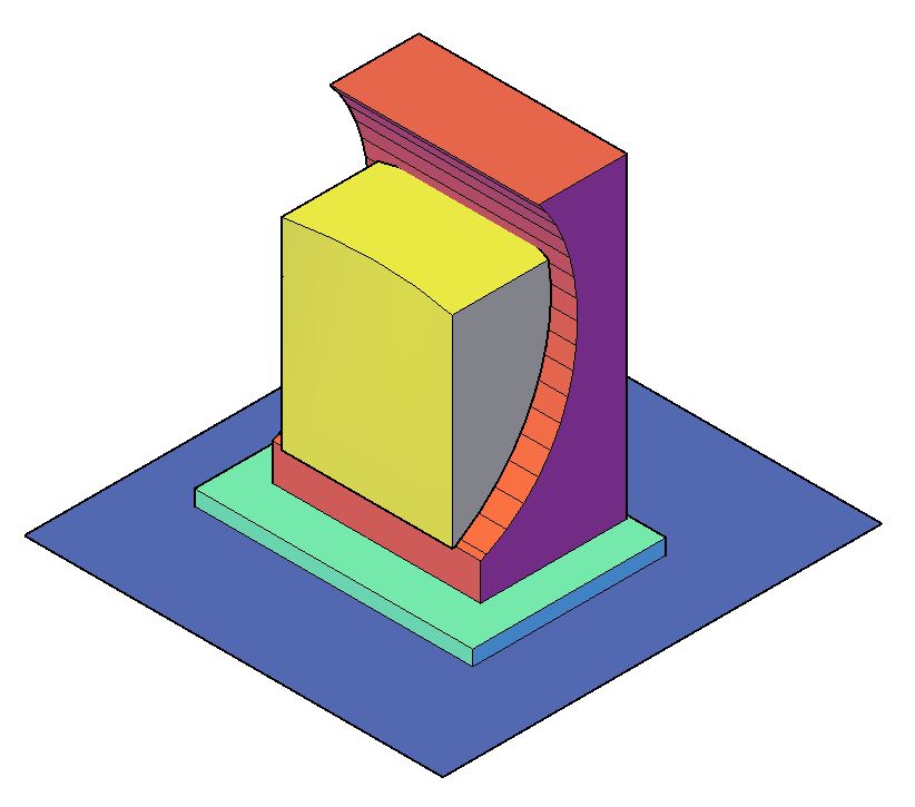

OK...I'm done.  I had to remove a portion of the red solid that projected through the curved magenta solid.  I did this using the Subtract command (on a copy of the objects) followed by the Separate command then erasing the protruding portion of the solid.

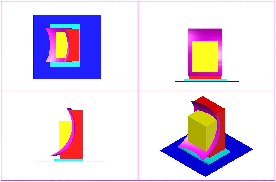

Last one then I am done (I think).  Four views.
