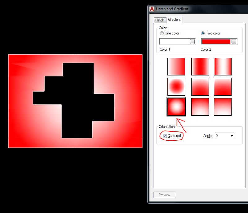

John Connor
Senior Member
Joined: 01.Feb.2011 Location: United States Using: AutoCAD 2018 Status: Offline Points: 7175 |
Posted: 27.Sep.2016 at 17:10 |
Well now that I have had a second look at the problem I think the answer is yes. Pick the gradient sample in the lower left hand corner of the nine possible combinations shown. Basically it is the "centered" option. Got it?
