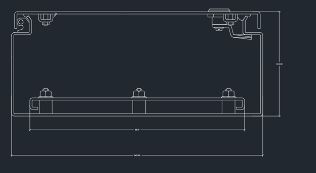

Sorry for the delayed response, i thought I would receive an email when there was something.  I am drawing a control cabinet in model space (2D), I have a standard template from the manufacturer.  This template is not exact for any of their cabinets, just a drawing.  In model space, I was hoping to covert it to a symbol and then use that symbol for all the different size by scaling.  Using SCALE, the x and y increase or decrease proportionally, however I would need my x axis to increase seperately than my y axis (only in 2D).
I'm hoping I can explain a little better, but with that 1 symbol I was hoping there were tricks or some feature in order to use that 1 symbol and specify that I need it to be a certain Height x Width  so I don't have to break the symbol or drawing and extend each side out manually every time I need a different size.
Also, I will be using a layout tab with viewports, but mostly to show detailed drawings of each section of the cabinet.  Right now I was breaking the symbol, using the Linear function to outline the height and width and the moving the bottom half of the cabinet down and the right side of the cabinet out to be about equal to correct Height x Width.

Does this drawing consist of only a rectangular outline?  If so, I would make a Block that's 1 drawing unit square, and you can Insert it using X and Y scale factors of the width and height for each instance.
If it has internal content in addition to just an outline, you could do the same if you don't need the exact proportions of the internal content to be precise for every size.  Otherwise, it sounds like a job for a dynamic Block.  Read up on those in Help, or Search for tutorials and videos about making them.

"If so, I would make a Block that's 1 drawing unit square, and you can Insert it using X and Y scale factors of the width and height for each instance."
I have never used this function, but seems like it might work.  After my meeting this morning I will try to see about doing that.  Thank you for the tip.  The above drawing is one side of what I'm trying to do, I will have a front and a side, but for each side I have to manually scale.  I will try your recommendation Kent.  Thank you!

I would suggest a dynamic block not a regular block.  Why?  Because as you scale the block upon insert it will not only affect the size of the cabinet but the bolts as well and you'll end up with non-standard size bolts/nuts.
