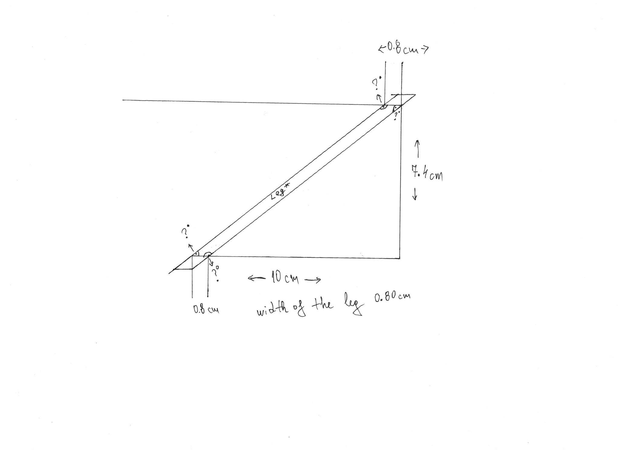

Hi guys, I'm new here, I hope I don't violate any rules, and registered with the purpose of getting some help with this sketch I've been struggling to do in a few days.
So what I'm basically trying to do is get the exact angles and measurements of the base of this table. I am in a dead end. So I will appreciate some help and someone do it for me. I know it's a really simple job, but I am total beginner.
So here are some pics of the table:
https://www.arredamento.it/tavoli-in-legno-grezzo_NG4.jpg
http://www.italianarredo.it/wp-content/uploads/2014/02/p-24546-shangai-base.jpg
What I can't do is to do the the "legs" on top and bottom to be at the same plane
Regards,
Sve

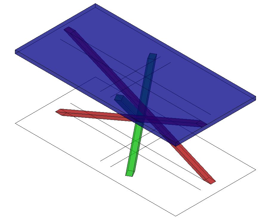

Well basically you just need two legs...one for each direction then mirror them.  As for actually constructing them so that the bottom of each leg and the top of each leg is at the same elevation you can use some temporary construction lines to keep everything in check.
Keep in mind that each leg passes over one leg and under another (like weaving).
Another way to do it would be to construct the four legs but make them longer than they need to be.  Then use the SLICE command and one of its several options (ex. - Surface or Object) to slice off the ends of the legs so they are all at the same level.

Well the centre console at least helps you position the legs as far as spacing goes but you still need to account for the over/under affect of the legs.  Personally that may be the more difficult part of the problem to solve (trial and error).  Getting the bottoms and tops of the legs at their respective planes shouldn't be all that difficult if you use the SLICE command as suggested.

Do you know if the legs that run the length of the table are parallel to the edge of the table or at an angle.  Those would be the two longest legs.  If that is the case then it would probably be fairly simple to create the 3D model given the proper construction lines.

Here is my version.  The legs running the length of the table are parallel to the edges.  The shorter legs have been rotated 30 degrees.

The legs pictured above do indeed go over/under each other.  BTW...I used the X-Ray visual style.
Given that you are in the U.K. and about 5 hours ahead of me it must be after 7 p.m.  By the time I arrive at work tomorrow it will be around 10 a.m. your time.  At some point our paths will cross again.  Until then it is almost time for me to take a very long drive home.  I'll check this thread tomorrow morning.  Good luck.  It isn't as tough as it may look.
Thursday morning here.  No response?  Oh well.
Just wanted to mention I did not use the SLICE command to create my legs.  I merely extruded a rectangle along the path of a sloped line.

Direct Link To This Post Posted: 22.Dec.2016 at 20:41
Hey Connor huge thanks for the help!!! I'm still struggling with the 2D version though.
So, basically, what I'm trying to find out is the exact degrees of the corners/angles that form up at the top and the bottom.
I'm uploading a quick sketch with horizontal and vertical lengths and with the width of the "leg" pointing out with questions marks what I'm looking for.
Up until now I couldn't manage to wrap it up, I know it's probably 5min job, but I am a total noob Embarrassed
Edited by Sve87 - 22.Dec.2016 at 20:42

John Connor View Drop Down
Senior Member
Senior Member
Joined: 01.Feb.2011
Location: United States
Using: AutoCAD 2018
Status: Offline
Points: 7175
Direct Link To This Post Posted: 23.Dec.2016 at 00:15
Looks like something you could easily draw in AutoCAD either in 2D or 3D.  Personally, I don't see what's stopping you from doing it.  Draw what you have pictured above in 2D using AutoCAD and derive the lengths and angles of any lines that you require the information for.
