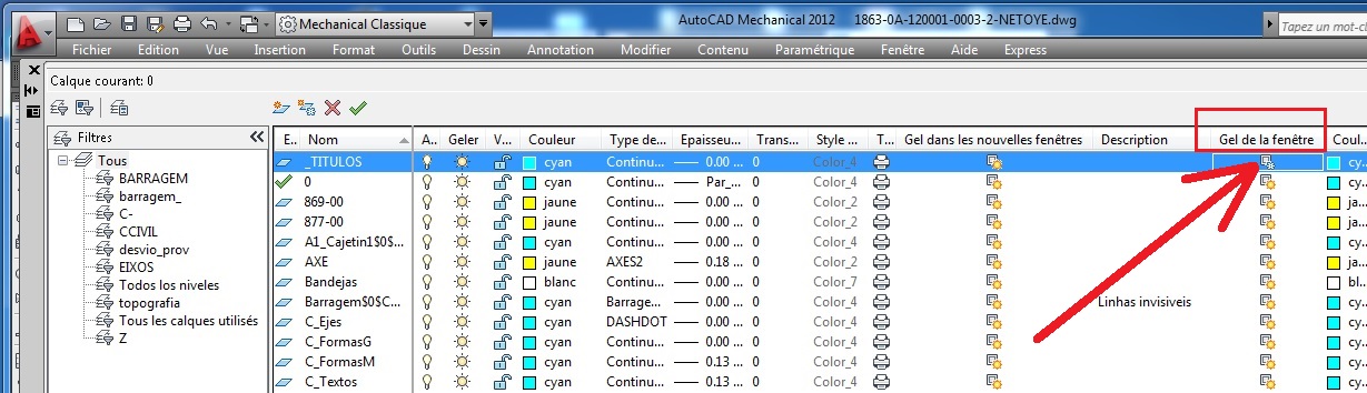

How do I hide objects in a viewport but not in another ??

Hello vader555555, for doing this you will have to go to the layout space, open the view port, open the layers control palette ( command LAYER ) and declare frozen certain layers.
If you do this like this, then the objects that you will put on that layer ( can be lines, arc, etc or even blocks constituted of anything ) will be invisible in that view port.
See the printscreen here in French.
Please tell us if this helped or not.
