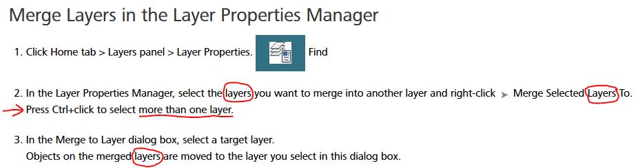

Direct Link To This Post Posted: 03.May.2017 at 15:48
The first method outlined in this article I believe answers your question.
https://knowledge.autodesk.com/support/autocad/learn-explore/caas/CloudHelp/cloudhelp/2016/ENU/AutoCAD-Core/files/GUID-D7F24669-483F-4589-96AC-557F08784E7E-htm.html

Direct Link To This Post Posted: 03.May.2017 at 16:10
I answered your question is my last post.  Maybe this will help....
