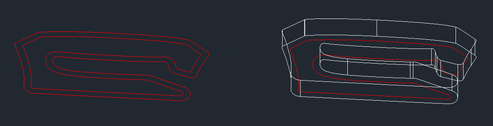

Hello All
I need your help for this isuee.
Here is what I want to make as 3D.
There is chamfer 1.66mm x 1.66mm.
I tried this.. but Autocad told me "Error ,Blend failed.. "
but I do not know why at all...
Here is starting point.
First, I draw this line with Adobe-Illustrator. and output DWG file.
and Open it....
I tried with 3 way.
1) With Chamferedge  --> failed.
2) With Blend only.. ---> failed...
3) with Sweep --> failed.
I hope Someone tell me why Autocad can not draw this simple shape..
Is this limitation ???
Could you help me ??
here is cad file
 uploads/724730/shape1x.zip
If AutoCAD is not possible to draw it,
How should I do ? Should I buy other CAD software to draw this only ?

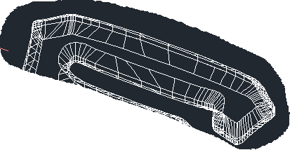

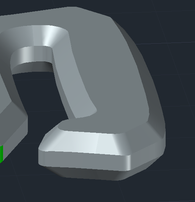

Well if you're more concerned about the end result (may not fully satisfy your requirements however) rather than the process I was able to achieve the following.  It was somewhat involved.  Maybe someone else here with better skills can arrive at a solution with less work.  And, yes, it is a 3D solid.  I checked.

I did not use chamfer.  I basically used a series of profiles that I lofted separately then unioned them (there were three) together.  But first I had to use the SPLINEDIT command and turn the outer spline into a polyline.

I also make it with LOFT + some guides.
but It is not beautiful than I expect.
There is lot of NOT good surfaces..

Sorry about late reply, I hope it will help... That's not a limitation of autocad what you said, I think your model suffers from bad junctions, or curves in the model. "Cannot blend" error is usually connected with inaccuracies in your 2d shape, for example 2 curves  are not perfectly blended with another curve/line(tangent)  between them. You should do a little "repair" of your curve exported from illustator - fillet the straight lines with radiuses so it gives a perfect blend or flow between the curves.
Even if you managed to get polyline from your closed shape or a region, that does not mean the CHAMFEREDGE command will work if curves are "badly" joined.
