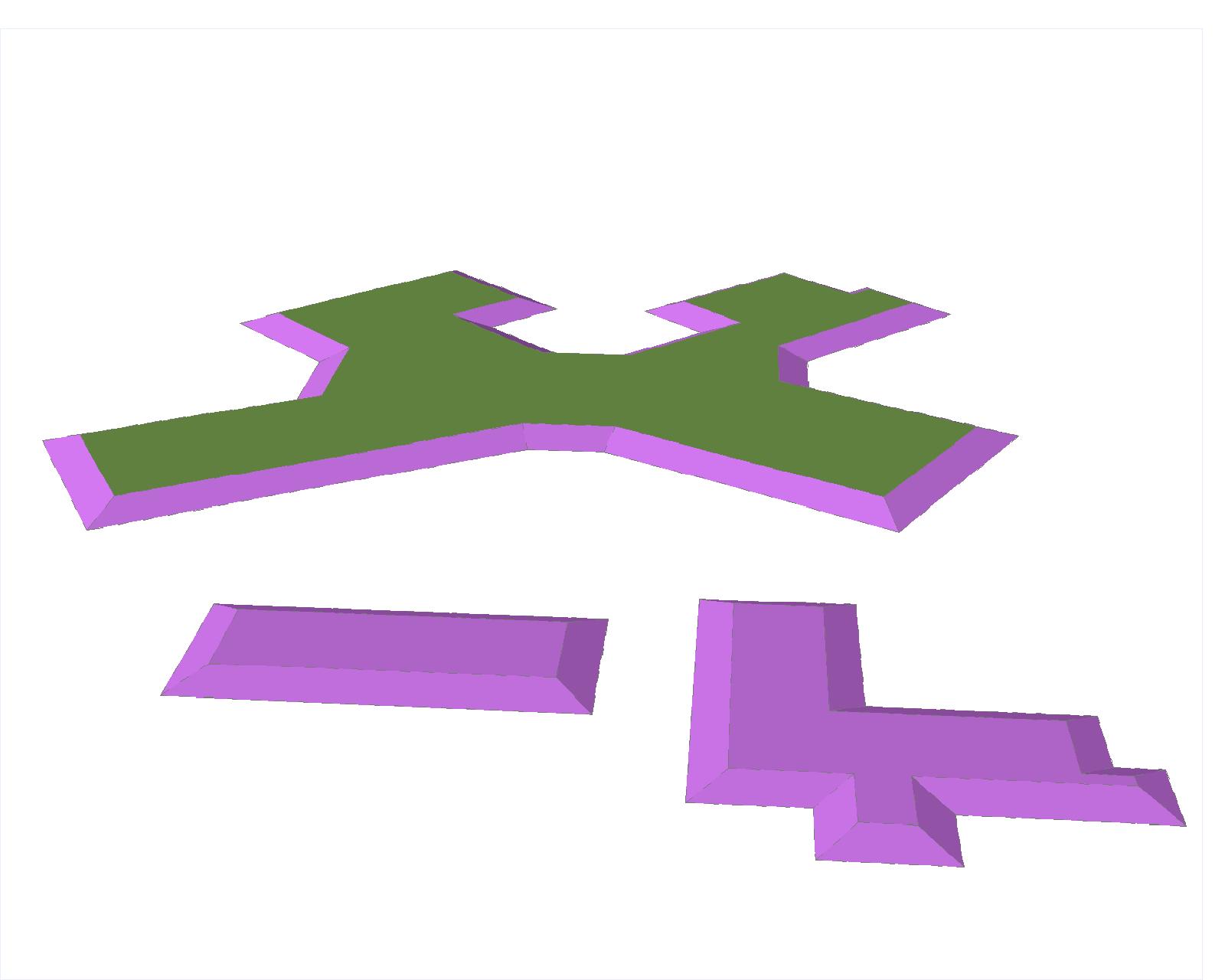

Then from the Solid Editing>Move Faces I selected the Top Face (checking that I only had the top face).
Set my base point then tried to set the second point but nothing happened.
After several attempts, I opened up a new drawing and tried with a simple layout - same result.
I then tried again with a rectangle - same again.
Below is a picture showing how far I can get.
All the tutorials just show click'n'drag to move the top face. I figure there must be a simple setting I don't know about.

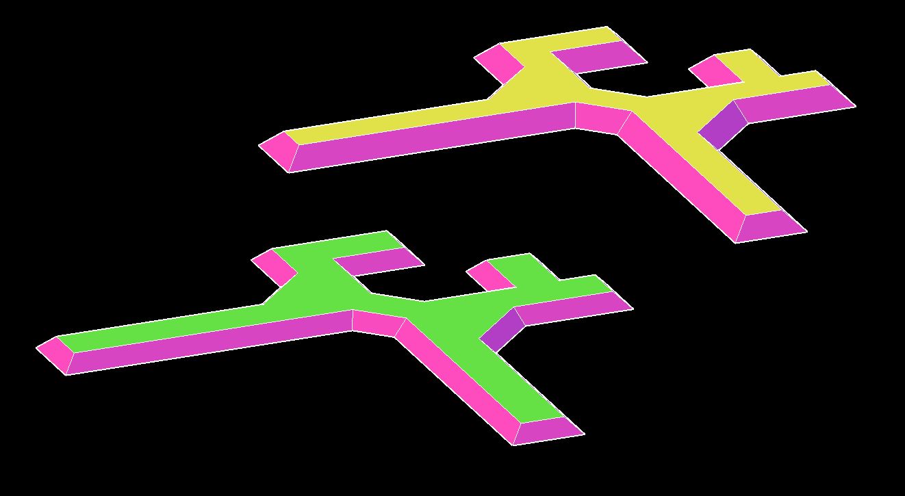

Direct Link To This Post Posted: 15.May.2017 at 16:36
For your viewing pleasure I offer the following.  The 3D model with the green colored face is the original prior to using the Move Face command.  The model with the yellow colored face is the 3D model after using the Move Face command to increase the overall height which would obviously change the angle.
You weren't trying to copy the face were you?

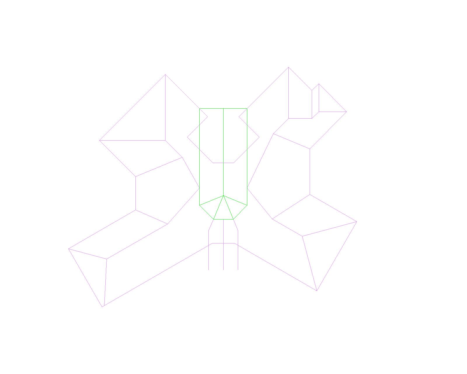

The result I'm after is to show the Roof Planes finishing with the Ridge, Valley and Hips.
In the tutorials, after reaching the results above, by raising the top Face, the side faces continue at their taper angle until they meet each other - The top face disappears.
Below is a link to a typical tutorial
Below is a quick Top view sketch of the Roof (The area in green is going to be another level above the general roof)
I realize that this particular roof shaped solid may have been to much for this method, however, I can't even get a simple rectangle say 6000mm X 4000mm to form as per the tutorials.
