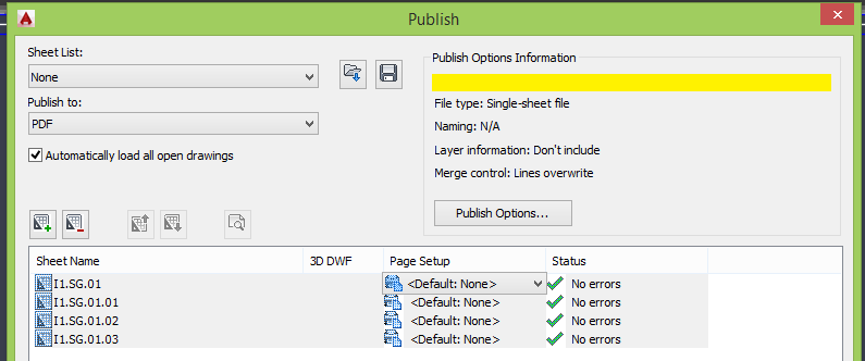

issue with batch plot (publish) from cad to PDF
receiving message - encountered problem?

What is your actual question?
What is the exact nature of the error message you are receiving?
Are you plotting from model space or from a layout?
Are you plotting to a network printer or a standalone printer?
Are the plotter drivers up-to-date?
When asking a question it just makes sense to provide as much information as possible so we can get right to the heart of the problem.

check the layout setting first in first sheet, make setting as u like. save it, through plot command with Add.. button. then publish. add the drawings & change the page setup as u save in first sheet. see image
