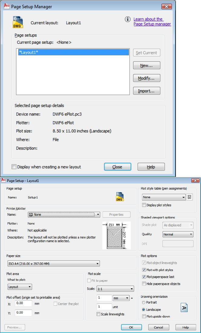

As far as I know I drew on 1/1 scale in model space. The annotation scale is set that way. Its an architectural drawing about 40' by 40'. In paper space when i click on the viewport and set the standard scale to 1/4" = 1' the drawing shrinks too small.

Direct Link To This Post Posted: 20.Jun.2017 at 17:18

Why are you using imperial units for the drawing scale yet plotting to a metric paper size AND using a metric scale of 1mm = 1 unit?
You are mixing apples and oranges and expecting it to work?

Well like I said its been nearly 20 years since using auto cad.  I started drawing without any thought to the settings until i got further into the project.  I was drawing in decimal feet which i figured was fine.  The page set up settings have been confusing to me although becoming more and more clear.  Are you able to tell me how to fix it?

I wasnt aware that I was drawing in imperial units or printing in millimeters.  It shows inches from what I see.

So can we assume you started with the default template file named acad.dwt and not the metric version named acadiso.dwt?
If you want to print the drawing out at a scale of 1/4"=1'-0" then shouldn't you also be printing to a 8.5x11 sheet of paper?
Please attach a copy of the .dwg file to your next post so we can have a look see.  That should end all doubt.

Hello Jsouth and John, Jsouth your file is set on feet as units ( command UNIT and take a look at what is shown as 20 years ago this didn't exist ).
Your print problems should be fixed with little things.
Eventually draw a rectangular viewport of 8.5 x 11 and play with the printing parameters.
Jsouth, I took a look at your file and it seems that the "problem" is the scale of 1/4" to 1'.
On a 8.5 x 11 paper size I would have set 1'-1/2" to 1" ( or ZOOM 1/8 XP ).
