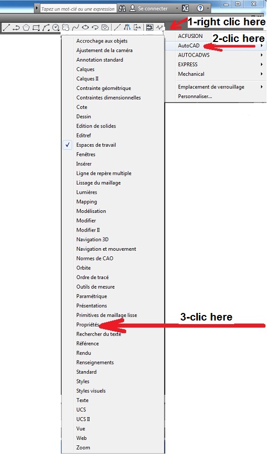

Hello popopo90 and John, you can also do it directly on the right top of your screen :
Please tell us if this helped or not.
