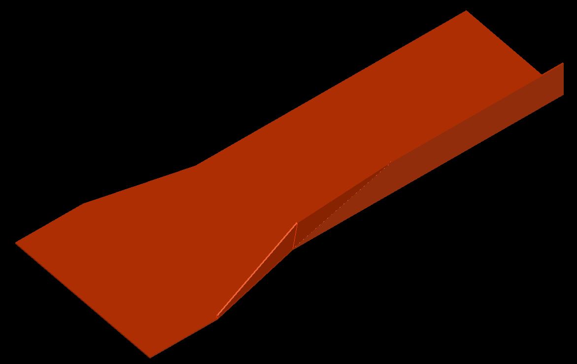

I have not idea how to connect two solid from the picture below so I would be grateful if somebody help me. dwg file attached.

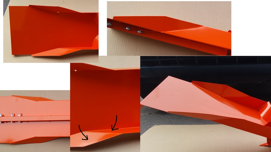

I don't have a second solid, just a one, that is the problem, I don't know how to draw second solid. Sorry, I set the wrong question. He has a angle on X and Z axis. If you open the dwg file, you see that there are not second solid.

Actually your drawing has two solids, a line, and two lightweight polylines. For the flared end you might try using the Loft command.
Are you working off of a sketch? Do you have any dimensions to work with? Do you know the angle of the flared portion of the object? Edited by John Connor - 02.Oct.2017 at 11:47 |

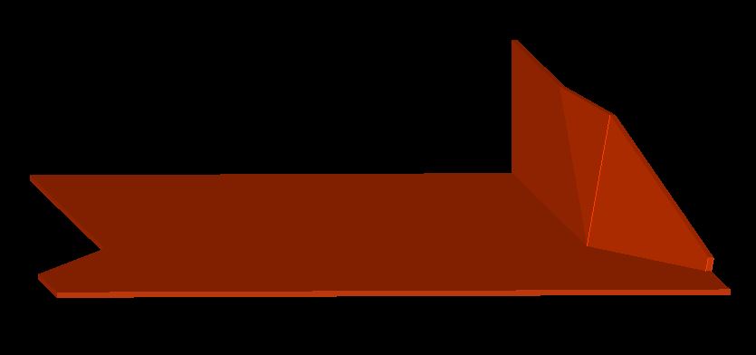

This is what I was able to create using a combination of commands including 3Dpoly, Loft, Region and Extrude. I set the angle of my flared section at 10 degrees.

Here is another view.

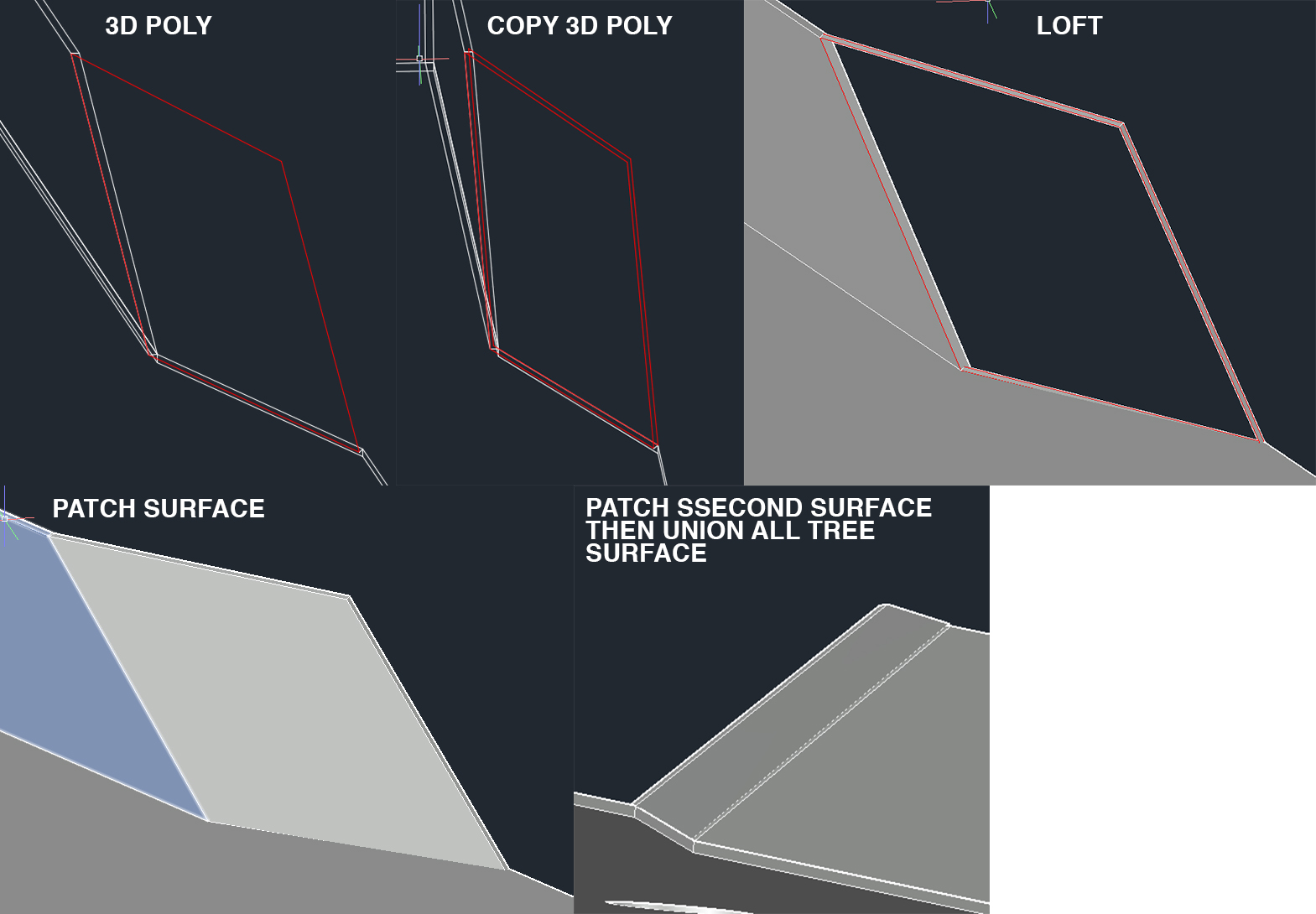

Hi John. I apologize for the delay with the reply, I had a lot of work.
And I found a solution similar to yours, look at the picture. Is there any option to convert the surface to solid? In Mesh panel that is option Convert to solid but it does not to apply on my surface. I'm not quite clear about your procedure, after the loft command is not going to apply to the Region command with me. It's a REGION command or another one? ![]() Edited by rdjavi - 06.Oct.2017 at 14:58 |

I'm sure there is more than one solution to the problem. My solution may be not be the best or the quickest but it worked.
There are two or three different ways to convert a surface to a solid but it depends on what you have to work with. Unfortunately I worked with your drawing on a different CAD system so I do not have the .dwg file to refer back to. I would have to start over from scratch and right now I am a little busy.
