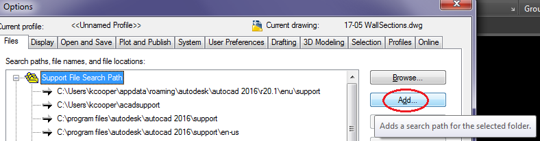

I suspect what you want is the OPTIONS command > Files tab > Support File Search Path list.  Open that and you can Add as many folder locations as you want, for AutoCAD to look in for such things:
