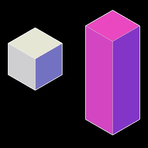

Direct Link To This Post Posted: 01.Dec.2017 at 00:22
Example: White color cube is a block 1 unit x 1 unit by 1 unit high.  Magenta colored version of cube was INSERTED with a non-uniform scale of 1 unit x 1 unit by 3 units in height.  BTW...the cube is a 3D solid model.
