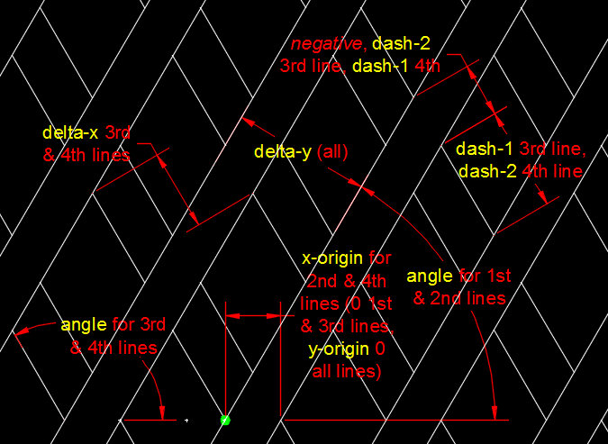

You can make your own, at whatever sizes and/or proportions and/or angles you want. Read about it in Help [>>here<< for 2018, but no different for earlier versions], draw up your specifics in a limited area, and use the image for what values to put where in the pattern definitions.
