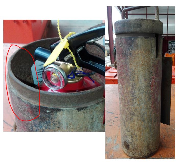

Hi.
Please help
An idea how I make the 3D drawing, the measurements can be any, only the detail of what is enclosed in the circle

Hello carlosban71, I'm afraid that this is very basic 3D. What do you know about 3D ? Do you know about convering lines, arcs, elipse to regions ? do you know about USC settings and viewpoints ?

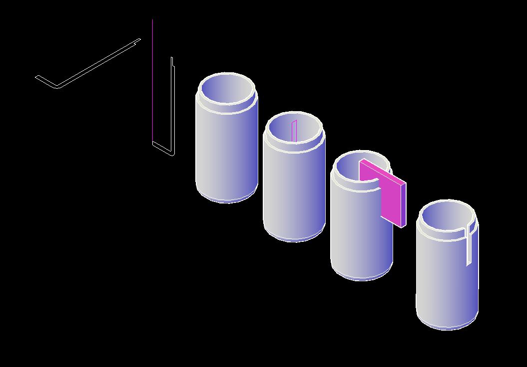

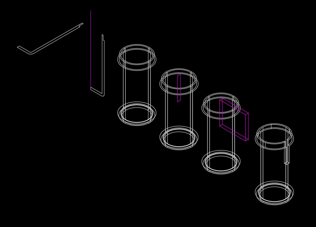

I would revolve a half profile then use an extruded rectangle to create a second solid that could be subtracted from the cylinder to create the notch.

Example.  Wireframe view.

Example.  Conceptual visual style.

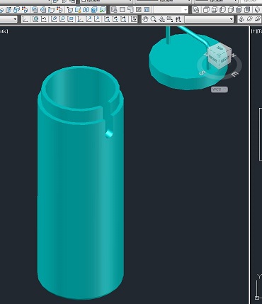

Great thanks, the most, because of work sometimes we forget the commands, yes I have knowledge

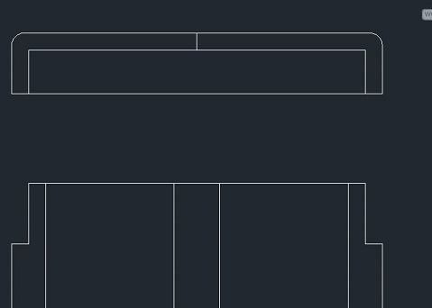

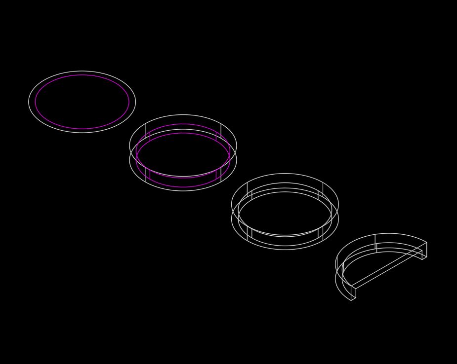

An idea to make the cover in 3D

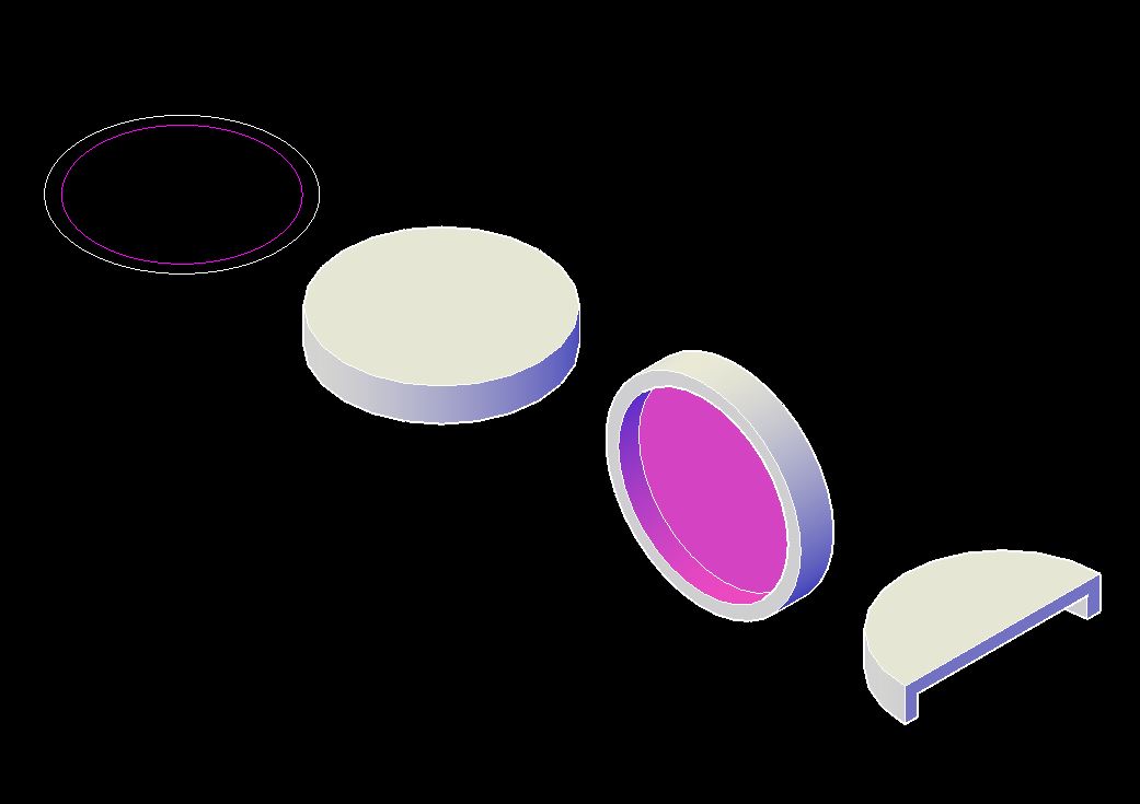

Same as the cylinder.  Create a profile and revolve it.  The handle can be created by extruding a circle along the path of its centerline.  Or....
Draw two circles one inside the other.  Extrude the outer circle to the overall height of the cover.  Extrude the inner circle to the height of the recessed area.  Subtract the inner circle from the outer circle; add handle.  Done.
No matter what method you use don't forget about the radiused top edge like I did in the examples below.  Oops.
Edited by John Connor - 28.Dec.2017 at 12:42
<<AutoCAD 2015>>

Direct Link To This Post Posted: 28.Dec.2017 at 12:34
3D cover using method 2 described above.  Visual style: 2Dwireframe.
<<AutoCAD 2015>>
