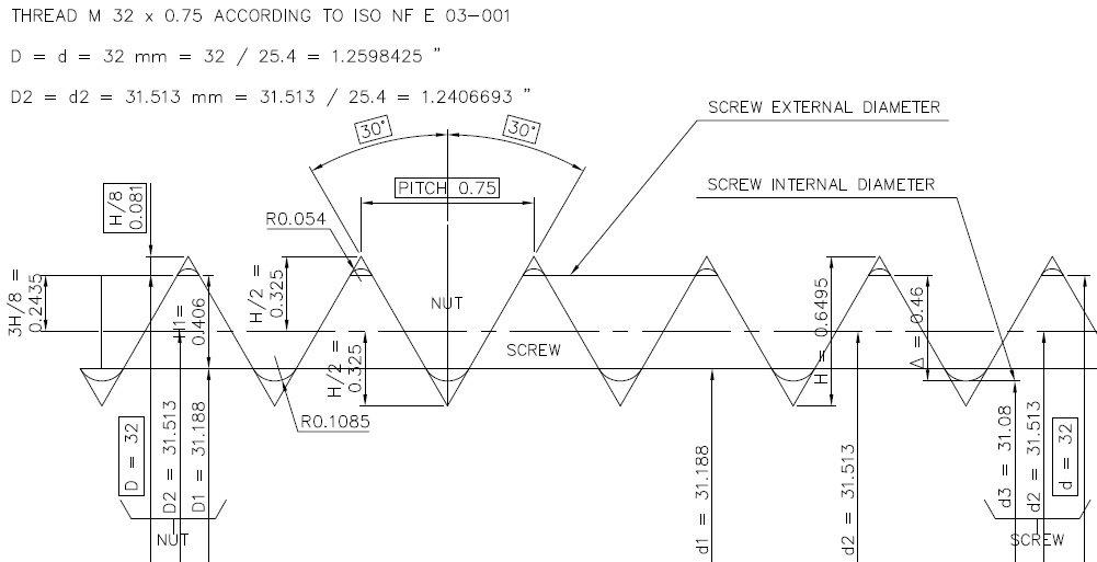

Trying to cut M32 x .75 threads internal and external (mating pieces) in Aluminum. having no success.
Using G92 threading cycle (please don't ask me to switch to G76)
For the external i cut my stock to my External major Dia but after threading the diameter grows upwards of .020. I expect a little growth but this is excessive. I know my pitch is right, but now i'm questioning my major and minor diameters that i found using an online calculator because this is a custom thread.
Max major Dia = 1.2589
Min Major Dia = 1.2534
Max pitch Dia = 1.2398
Min Pitch Dia = 1.2353
Anyone got any suggestions? I need help.

Hello Brian, I have uploaded a file in the CAD / BIM Library : SCREW H M 16 x 35.dwg with inside the example for diameter M 32 x 0.75.
All this is in accordance with what you can find at WIKIPEDIA ISO metric screw thread
Please tell us if this helped or not.
Edited by philippe JOSEPH - 04.Jan.2018 at 09:55

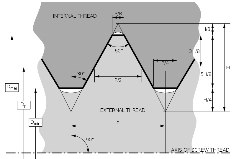

Direct Link To This Post Posted: 05.Jan.2018 at 08:25
Hello Brian, I joint this picture because I don't know if you have AutoCAD.
