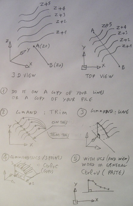

Hello,
Is there anybody who can help me how to create grading line (survey plan)
for my elevations? The site has slope grading.Confused

Hello Lexville, we are talking 3D OK ?
If I understand your question, you have a 3D file with elevation curves or lines at various elevations ( Z ) and you want to "cut" them in a top view to create a line in elevation 2D view.
Please tell us if this helped or not.

Hello Lexville, I maybe have some 3D file with a house on it ( maybe an old AutoCAD file loaded in the samples drawings named house.dwg if I remember the excact file name ) but it will be tomorow at work but is what I supose to be your question correct or what you whant is : how to draw elevation lines in 3D?

I need in 2d. On how you project the slope from the survey plan. Example for elevations and for sections, So i can see the slope of the site.

Direct Link To This Post Posted: 08.Jan.2018 at 22:05
OK than it should be what I have figured in my first post and it's 3D work.
I will try to do it step by step on a real AutoCAD 3D file tomorow.
What do you know about 3D, for me the first step is to learn about UCS and viexpoint, then to try and work files of your own.

Hello Lexville, I have uploaded in the CAD/BIM Blocks library here in the site the 3D AutoCAD file : HOUSE01.dwg.
Follow the steps from 1 to 8.
I hope that it will meet your requirements but it's a 3D work with all it's specificities.
For me first of all is the knowledge of UCS ( all the options ) VIEWPOINT, etc...
Ask for more or place here a copy of your AutoCAD file.
