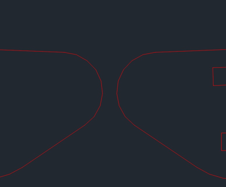

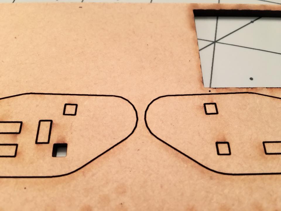

Hi,
I'm having an issue drawing in CAD 2016 LT. I'm using the files to print on a laser engraver. As you can see in the pictures I cant print a perfect circle as its printing "low vector" files. Is there a setting in CAD to fix this? The software I'm using to print is CorelDraw. Thanks.

Did you utilize a DXF file from AutoCAD then opened in CorelDraw?

Yes, I exported as a DXF file to import into CorelDraw.

Have you seen this?
https://community.coreldraw.com/talk/coreldraw_graphics_suite_x5/f/coreldraw-x5/24697/beginners-question-smoothing-lines-for-laser-cutting

I will read the information there, it seems as its the same problem. Thanks so much!
