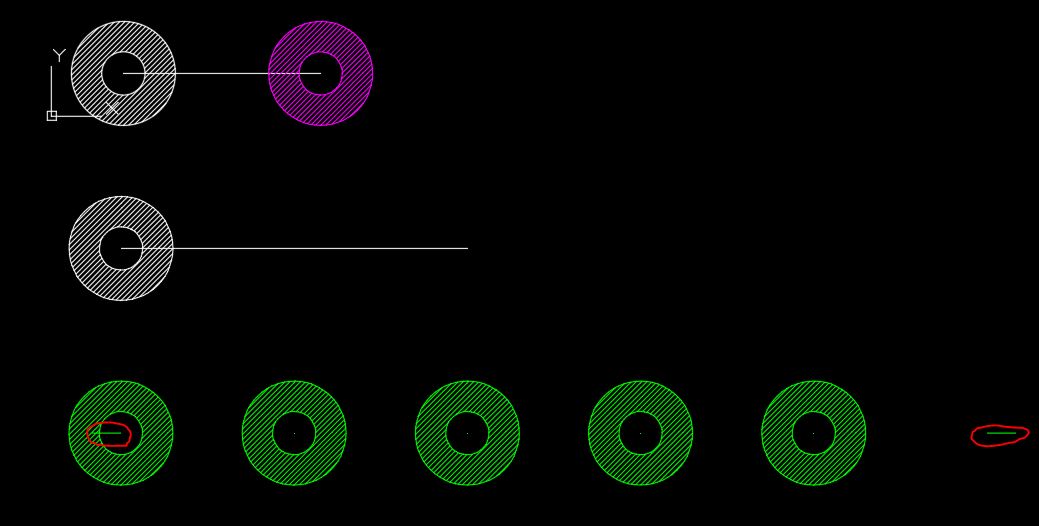

I need to make a custom line type using a 36" o.d. and a 15" i.d. donut. or a filled circle.
I have been trying to first make a shape with the  donut and this does not seem to work.
Also tried to use two circles and a fill, still does not work.
Any ideas?
Thanks
Wayne

How about two circles and an exploded (dense) hatch pattern?

Tried that. Did not work.
Next?

Can't believe this is that hard to make happen. It will work if the area is not filled.

Almost there but not quite.  Yeah, the hatch pattern isn't dense as this was just a test.  The problem to solve is getting rid of the spurious little line segments circled in red.  I called mine DonutHoleLT.lin.  The magenta color donut at the top is the shape file.

....  The problem to solve is getting rid of the spurious little line segments circled in red.  ....
I'm afraid that's not a problem that can be solved, it being the nature of anything open-ended drawn with any non-continuous linetype to "fill out the ends," beyond full cycles of the linetype definition, with continuous extensions [in closed objects, it can make adjustments].  You can minimize them by adjusting the length of an object [when that's not made impractical or impossible by other considerations], but you can't get rid of them entirely.

How critical is the relationship between the 36" vs. 15" dimensions?  Could you use an embedded-Text linetype instead of an embedded-Shape one?  For example, the 0xA3 character in the Wingdings font looks pretty much just like that (when I make one 36 units wide outside, its inside diameter is about 14-1/2 units), and it's truly solid-filled, so you don't need to fake that part.

Good suggestion Kent.Thumbs Up

I only has to be close, give or take a couple of inches.

Then follow Kent's suggestion.
