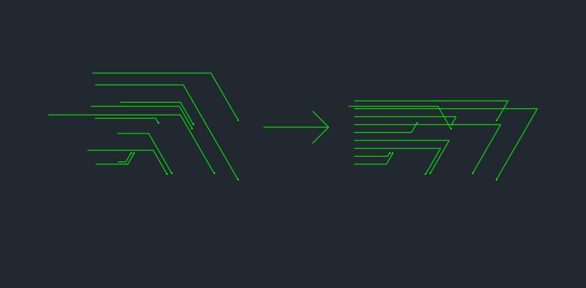

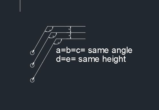

HELP, does any one have a method or lisp can make multiple leader arrange and match same angle ,because my job need to make a lot of multiple leader arrange ,anyone can suggest solve the problem ??
Multiple leader need same angle same height,does anyone have a method?

Obtaining the same "spacing" (i.e. - height) between multileaders can be accomplished via the ALIGN option.  As for the angle I am not sure there is an option for that.

but i try multileader algin, how can i change from leader to mleader, i found a lisp can change to mleader , but once time only can change 1 leader to multileader , how can i change all leader to mleader faster
because my job need to align over 300 leader and align , this too waste my time

Senior Member
Senior Member
Joined: 14.Mar.2011
Location: France
Status: Offline
Points: 1530
Direct Link To This Post Posted: 27.Mar.2018 at 07:36
uploads/175428/MULTIPLE_LEADER_ARRANGEMENT_01_A.dwg
Hello Mikewong0719 and the others, please find here an example of leader arrangement and it's different from your example.
Please show us a drawing of yours.
Edited by philippe JOSEPH - 27.Mar.2018 at 07:37

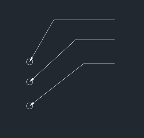

Direct Link To This Post Posted: 28.Mar.2018 at 04:04
how can i know it is follow which leader is buttom??
