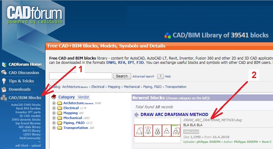

Hello dery and kent, see the file : DRAW ARC DRAFSMAN METHOD.dwg in the CAD/BIM Blocks library here in the site.
Dery, please try and search a little...

Could you please show me the link? I already searched for the one you mentioned above but still can't find it.

Put your glasses on.  This website (i.e. - The CADforum)....CAD/BIM Blocks.  The drawing is the very first one at the top of the list.  Doesn't get any easier than that.

Hello dery, the CAD/BIM Blocks library is here and you need 2 clics to reach the AutoCAD file.
