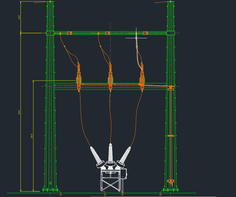

Direct Link To This Post Posted: 31.Jul.2018 at 16:17
I am looking to transform this for example into 3D. I am unsure on where to begin to do so

Direct Link To This Post Posted: 31.Jul.2018 at 19:43
Start with the steel structure (i.e. - baseplates, columns, beams).  Next up would be any equipment (i.e. - conductors, insulators, isolators, oil circuit breakers, bus bars, lightning arresters, etc.).  Do you have all the necessary dimensions available?  Wires can be created by sweeping a circle along the path a spline.
