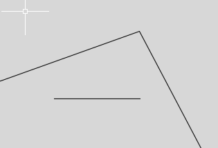

Topic: How to move a line into an anglePosted: 30.Aug.2018 at 10:30 |
Hello everyone
i hope you are all fine. I have a strange problem. I want to move a specific dimensions horizontal line into an angle of 2 other lines so it can fit and create an triangle(i am attaching image).
I dont know how to do it. Can anyone help me? thanks in advance |

It is not that easy - AutoCAD cannot perform dual osnaps. But you can help yourself with parametric constraints.
See the video: |

Thanks for your post and reply
It was very helpful. Indeed this is one way Thanks again
