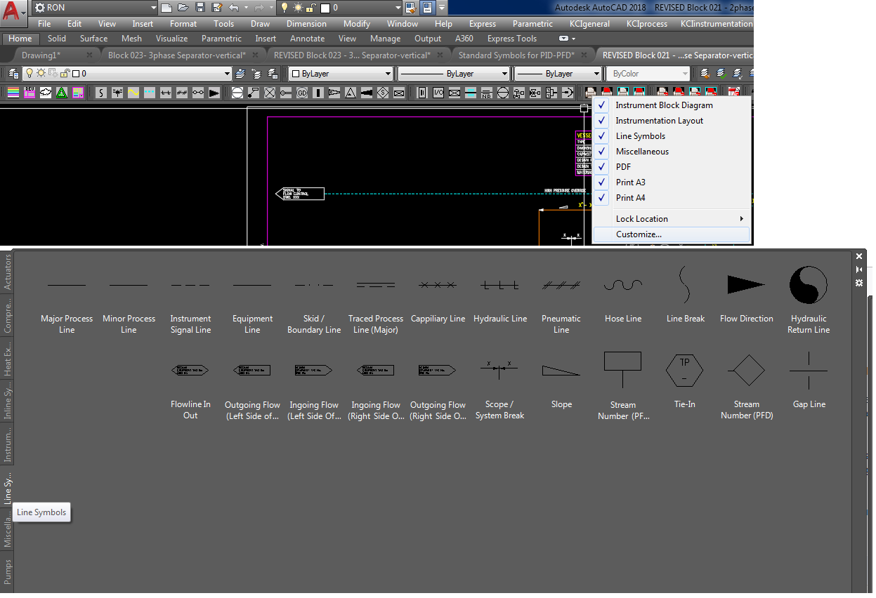

1 write a drafting manual this will make it easier and clearer for your colleagues.
2 create templates (or what you mentioned sheetsets with preset styles such as your dimension style)
3 Create a company standard acad environment (work space) such as toolbars/tool pallets e.g. line types/symbols/printing/client logos etc.
Hardest thing i think is getting everybody on the same page Wink
e.g.
Back to Top
