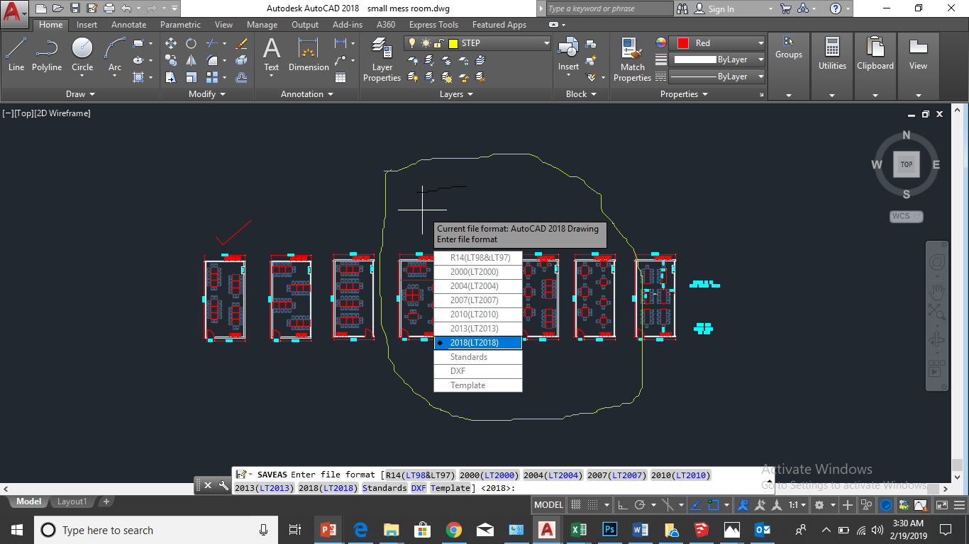

NOT ANY DRAWING SAVING AS IT SHOULD BE,,,,, WHEN I PRESS Ctrl+S... ITS NOT SAVING AS IT SHOULD BE. PLEASE ANY HELP ME TO FIX THIS ISSUE. ALSO FIND ATTACHED THE SCREENSHOT SO YOU CAN EASILY UNDERSTAND THE ISSUE.

What file format did you want your drawings saved to?

2010 format

What is FILEDIA set to?  It should be 1.

I GOT IT.
