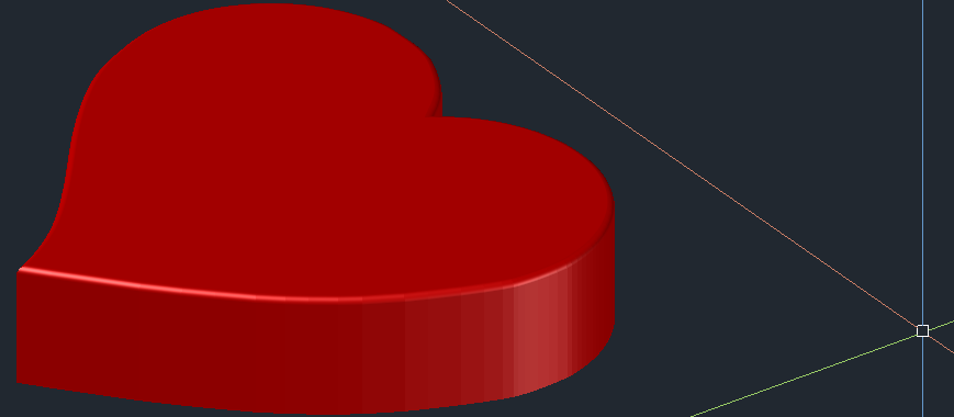

Hello all,
following this for forum for a long time. Now i need help, from you.
what is the command to round the top of this piece? Thanks, ![]() |

FILLET ? |

FILLETEDGE
if you make a it a good Solid object

Thanks, but it's not enougth. I want completely round.
i want to do like the photos: ![]() |

You might have to extrude the object an extra distance then slice it in two different planes using an arc or one half of an ellipse. So the slice (with object) would be made from front-to-back and from side-to-side. After each slice delete what is not needed.
