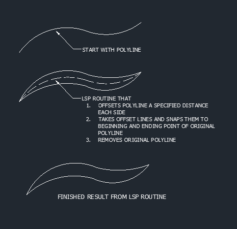

I am working on a project that a lisp routine would help a lot.  The problem is I don't know if it is even possible. I assume it is, but don't know.  Thought someone here with more knowledge would be able to tell me if it is.  I have several polylines that need to be offset to a variable I enter and then snapped back to the beginning and ending of that polyline that it is offset to.  I know crazy.  I attached an image to illustrate what i am talking about. Let me know your thoughts. ? Thanks!

Hello MoeJoe, I don't know if the lisp is possible but when I draw with your method the last 2 polylines are with an angle in the middle.

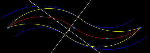

If it's always a two-arc-segment Polyline in which the two segments are tangent to each other [red]:
Offset the Polyline to both sides by the desired distance [blue].
Type SNAPANG, and for the angle, Osnap ENDpoint to the mid-way vertices of any two Polylines, to get the skewed crosshairs [white].  One of the crosshair directions is the tangent direction of all 3 Polylines at their mid-way vertices.
ARC command, start at one of the mid-way vertices of a blue Polyline, use End option and pick a far end of the red Polyline, then use Direction option, and with ORTHO On, specify the tangent direction for the Arc [yellow] to head in from its start point.
Do the same 4 times, or if it's a symmetrical original Polyline, twice for one side and do some grip-edit Copying and Rotating for the other side.
If you want a single-Polyline result, use PEDIT's Join option or the JOIN command to connect the yellow Arcs.
The equivalent could be made into an AutoLisp routine, but first verify that this is the situation, and the result you need.
