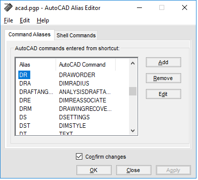

Hi,
Shortcut is "DR"
Adjustable via "Aliasedit" if preferred.
Regards
Edited by rebellio - 20.Jun.2019 at 12:44

Direct Link To This Post Posted: 20.Jun.2019 at 08:12
hello,
is there an shortcut for draworder send to back and bring to front?
