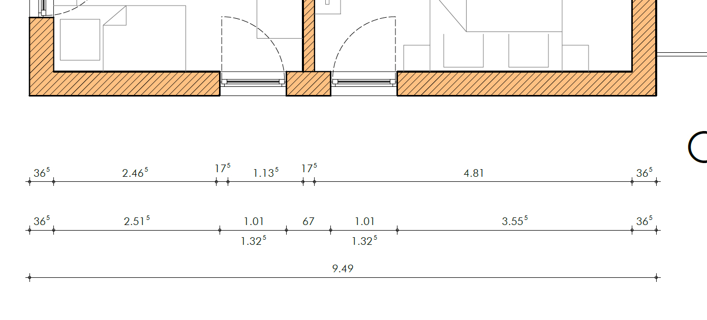

Do anybody know how to change classic dimension style to german dimension style ?

See the Czech tip:
https://www.cadforum.cz/cadforum/kotovani-s-posledni-cifrou-textu-jako-hornim-indexem-tip8491 Roughly: Precision = 0 Rounding = 0.4999 Suffix = \H0.6x\S5 Suppress zeroes = trailing |
