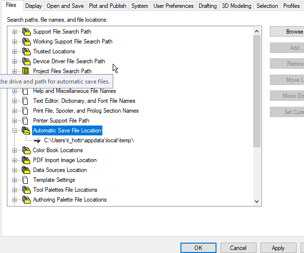

Hello sean, of course you have to rename the XXX.bak file to XXX.dwg to open it.
You must have also the automatic save somewhere in your computer, ask how to search it if needed.
https://knowledge.autodesk.com/support/autocad/learn-explore/caas/sfdcarticles/sfdcarticles/Change-default-location-for-automatic-save-files.html

Direct Link To This Post Posted: 22.Dec.2020 at 10:08
