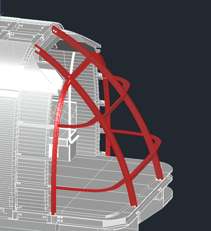

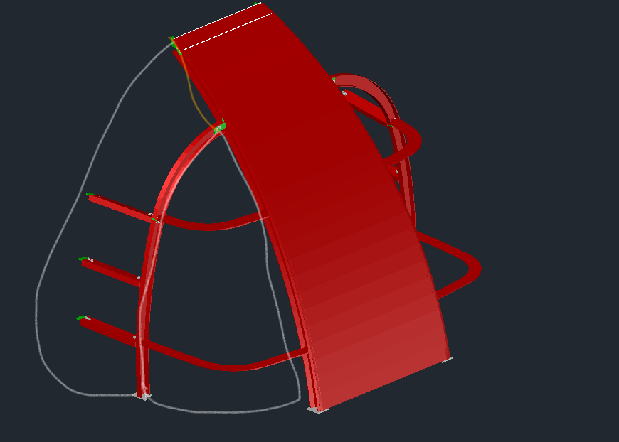

I have drawn the structural part in  the mrt project in Advance steel but i couldn't able to draw the inner and outer cladding.Guys help me to resolve this problem,It stressed me a lot in the past few weeks,Its urgent, I have drawn the front side cladding of the nose part but how to draw the side portion?

Hello Anantham, I don't know Advance Steel but I know AutoCAD and I would do these shapes in surface 3D with the command EDGESURF after having set the 2 variables SURFTAB1 and SURFTAB2.
AutoCAD will do the job with facets because the shapes are not common but twisted.
Ther are maybe possibilities to "transform" these surface shapes to real 3D and there are TIPS here in the site for this.....
Also try RULESURF that you will have to explore...
Eventually see the AutoCAD file that I have uploaded : ROND_CARRE.dwg about how to draw and unfold a square/rond in the CAD/BIM Block library here in the site.
Please tell us if this helped or not.

Thank you my friend PHILIPPE JOSEPH for your valuable ideas, I tried the above methods you mentioned but i couldn't able to attain the shape i need.I uploaded my dwg file for further understanding of that part, my friend if you have time try it on your side and let me know if it works, dwg file name:Nose_part-Inner_and_outer_cladding.dwg 21285

Anantham I'm not abble to open any DWG file right now.
Did you try EDGESURF between 2 arcs, one very little on the top and one of the right radius on the bottom ?
I suppose that you will have to modelize each sector in at least 3 parts conformably to the different radius at the bottom.
I will try to do some tests but I have only a very old AutoCAD release in house.
