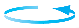

This is another example of the arrow.

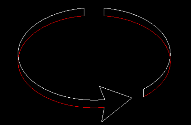

I roughed this out in a couple of minutes using the Ellipse, Line, Copy, Mirror, and Trim commands.  Yes, it is not an exact replica of the image you posted, I realize that, but the technique would be exactly the same.  Note: The ellipses are the same.  I created the one in white first then I copied it to a position lower than itself.  I changed the color of the copied ellipse to make it show up better for demonstration purposes.

Really?  It's merely the intersection of a line parallel to the small vertical line to the right and the red ellipse.

This is just basic AutoCAD 101.  No math.  No convoluted geometry.  The construction line would be parallel to the small vertical line to the right, in the image provided, and long enough so that when you extend the ellipse (temporarily) it will create an intersection with the construction line.
