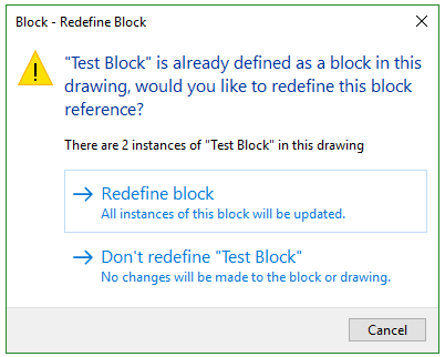

Direct Link To This Post Posted: 01.Sep.2022 at 09:41
This is the command prompt that used to appear everytime I inserted a block that was already in the drawing.

Direct Link To This Post Posted: 07.Sep.2022 at 15:38
I believe it depends on how you put the Block in.  If [in Acad2020 that I have here] you use Copy/Paste of a Block insertion from another drawing, or choose it by double-click from the Blocks chart inside another drawing using the Design Center, it uses the current definition of that Block name in the current drawing, ignoring the difference if the one from the other drawing is not the same.  If you use an INSERT command and choose a drawing file with the same name as a Block already defined in the current drawing, it asks whether you want to redefine it [= your dialog-box image].  If, in the Design Center, you instead right-click on a Block thumbnail with a name the same as one in the current drawing, it offers you the choice whether to Insert using the current definition without Redefining [what you get by just double-left-clicking on the thumbnail], Insert and Redefine, or Redefine only [without Inserting another].

Direct Link To This Post Posted: 07.Sep.2022 at 16:56
Hi Kent
Using the design centre and right clicking is a workaround I've discovered, but I tend to copy and paste from one large drawing that contains many blocks that I commonly use - a bit like a autocad reclamation yard. I would just like to know if it's possible to turn this prompt back on somehow when you copy and paste - not sure why they removed it?
