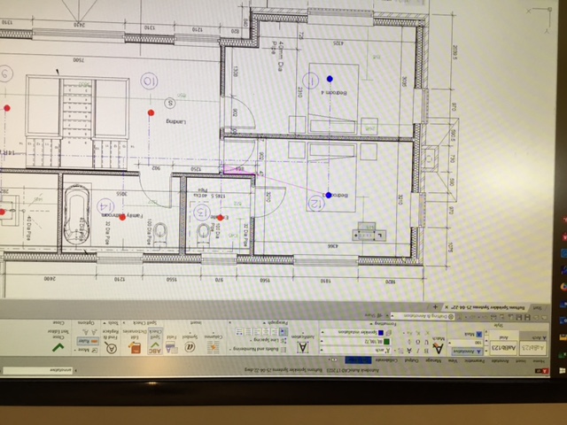

Autocad LT 2013- recently upgraded from 2019 and didnt get the problem before where I had a format text command and the drawing template in paper space was drawn in 2019 or maybe even an earlier version as it is one I have used for a long time
Problem I have is that text that I write in model space is not appearing in paper space viewport. I have written the text in a layer used for the rest of the drawing which appears fine
I have checked and no frozen layers or frozen in viewport
Seems to have formatted with annotative text if that makes a difference
This first picture shows a green dimension line without text, the second picture shows the model space with text number and text ribbon
any help would be gratefully received
Thanks
Andrew

Fixed it- found where annotative had been added to the text format and (dont know why) removal of that allows the text written in model space to be displayed in the  paper space viewport
Andrew
