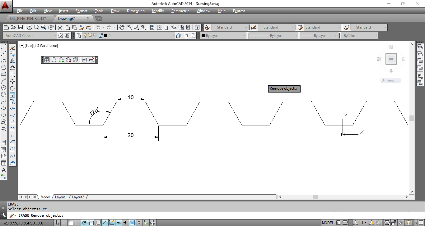

Wait a second, how do you create an oil ring with profile like this?
Back to Top
Senior Member
Senior Member
Joined: 14.Mar.2011
Location: France
Status: Offline
Points: 1530
Direct Link To This Post Posted: 08.Nov.2023 at 17:27
Hello dery, I will take a look but it's not the way it looks on the first photo and not how oil rings looks.
If you want the 3D model you should give me ALL the other dimensions of that GIANT oil ring.
At a first glance I think that I will have to do a twised inclinated part to joint the dimension 10 and 20.
