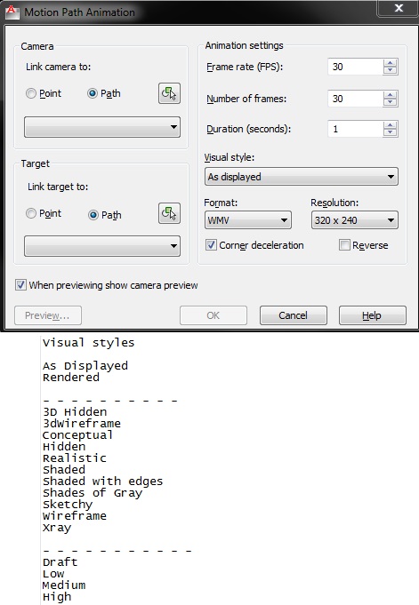

Hello,
I have a residence that I rendered for a customer and I wanted to showcase the whole front with an animation video.
The animation settings I chose on the window were the following:
Frame Rate: 24FPS
Number of Frames: changed automatically when I entered the 24FPS
Duration: 15 seconds
Visual Style: High
Format: WMV
Resolution: 1024x768
When I clicked OK it said that it would take 3hrs at first but about 5 minutes later the time increased to a little more than 4hrs, which is fine. I left it doing it's thing overnight.
I came in to work this morning and wanted to watch the video. It is awful. The quality is super low to say the least. I would not use this at all for my customer. I wish I could be able to share it with you so you could see how bad it is.
I should add that when I started working at this company they had computers that were not up for this kind of work.
I requested for them to do an upgrade on the system and they told me to order what I thought was good for me to do my job without any trouble.
On February of this year 2023, I ordered this computer specially for AutoCAD drawings with the best and latest video cards for high resolution, enough horses on the RAM, 1T memory and everything. All recommended by professional technicians.
I noticed the difference from the previous computer to this one and never had any issues. The previous computer took almost a day to make the rendering into a real photo image. This one takes about 15mins just to give you an example. It's amazing, I love it.
Do you know why this happened? I thought I had done something wrong on the process but the animation settings aren't that many nor complex. These are simple settings.
Is it something that can't be done with AutoCAD maybe?
I hope that you can help me please.
Thank you ??

Hello Precastman, I do some ANIPATH but not rendered and it could be the quality problem if too complicated more of this if you say that it takes hours.
Eventually see my AutoCAD file : CUBE_ANIPATH_02_16.dwg in the CAD / BIM Library.
Personnally, as the settings can be difficult to set, I do a first anipath of a very short time just to correct the zoom, etc. settings.
Did you test it in realistic medium ?
