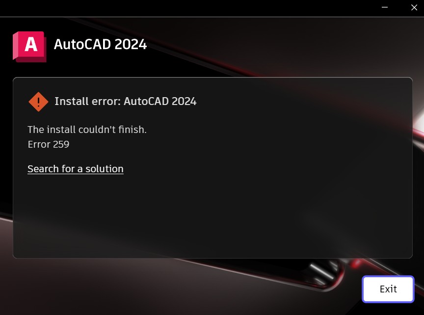

Folks,
I just wonder that i got error 259 while AutoCAD 2024 Installation. The installation process couldn't finish ![]() anyone has same experiences? please share and suggest for the solution. Computer: ASUS TUF F15 OS: Windows10 many thanks |

Is it a standard installation or a preset installation script? If a script, try to add "/w" to the parameters of "setup.exe". If standard, check your .NET Framework installation in Windows. And switch off your anti-virus temporarily.
