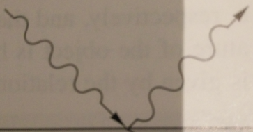

Do anyone know how to draw wave-alike object like attached pic in AutoCAD 2014?

That was done with this Shape definition for the 180-degree arcs that make the S-curve:
*146,7,ARC180
2,018,1,10,1,044,0
[the 146 can be any number unique to the file, within limits] and this linetype definition:
*S-WAVE
A,.0001,-1,[ARC180,YourFileName.shx],-2,[ARC180,YourFileName.shx,R=180],-1
If you need to, study Help about using COMPILE on the .SHP file that has the Shape definition in it.
At an effective linetype scale of 1, the radius of the arc parts is 1 drawing unit, so the overall S-wave width is 2 units.  When used in a Leader as in the image, you can monkey with the linetype scale in relation to the DIMSCALE setting to adjust the relationship between arrow size and S-wave width.
It looks like your arc parts are actually a little less than 180 degrees, and that could be done, but it's more complicated than a clean 180.

I can do this wave-alike object construction using arc command.
But, I think it's not arcs.
As you can see on the below pic (the one that I draw by red line), this curve has slanted tangent and it looks like a continuous curve such as spline or something like that.
So, how do you draw exactly similar like the pic?

It could be closer by using a "fractional arc" in the Shape definition instead of the "octant arc" that I used for my previous reply.  See the 00B or 11 code entry >here<.  That could define an arc of a little less than 180 degrees [upper part of image below].  But that would still be an arc of constant radius, not spline-like.  To get more "refined" about it, as a Shape for a linetype definition, would probably require an approximation using line segments [as many as you feel makes it curvy-enough-looking at the size you would use it].  Or maybe an arc for much of it, with short line ends [lower part of the image].
A non-linetype approach could build the whole thing as a Spline, as I've seen some routines do for batt insulation repetitive S-curves, but that would take a lot more memory, and would not adjust itself automatically if you needed to change the length, etc.

That gets to it, for me.  Go to 00B.  Maybe the 00C approach will be as good, possibly easier to understand.

I do think the OOC / 12 special code is easier. This shape definition makes an arc of [about] 150 degrees sweep:
*146,8,ARC150
2,018,1,12,2,0,90,0
It should work to just change the ARC180's to ARC150's in my earlier linetype definition [I haven't yet tested it].

If you're talking about constructing the thing out of pieces, draw an Arc however you prefer it, and some Copy and/or Rotate and/or Mirror and/or Array commands will make the configuration.  Add some Lines and an arrowhead at the ends.  Surely you can figure that out.  You could join all the parts [except perhaps the arrowhead, depending on what kind of object that is] into a Polyline if you want it as one object.
What I'm talking about is a custom linetype, with an embedded Shape, with which the entire arrowhead and straight-line ends and S-waving part can be one Leader object.  But unlike the join-into-a-Polyline version, it will adjust its number of waves if you change the length, and the wavy part will remain straight from end to end and aligned with the straight end extensions no matter what.  And you can change the size of the waves with the linetype scale, with the same overall length and the same arrowhead size [unlike the Polyline version in which Scaling to change the size of the waves will also change the length and the arrowhead], with the number of waves adjusted automatically for the different size of them.  Etc., etc.
There is one potential drawback to the linetype approach.  It can do its embedded parts only in full cycles of the linetype definition.  That means it can do the arcs that make up the wave only in pairs -- one up bulge and one down bulge must occur together, that is, only in whole S's.  So it would not be able to duplicate your image exactly, where one of them has an even number of bulges [it can do that, as in my first image] but the other has an odd number [some full S's and one half-S -- not possible with the linetype].
But here's the result of that 150-degree-arc Shape definition used in the original Linetype definition [with the adjusted Shape name], used in a Leader:
