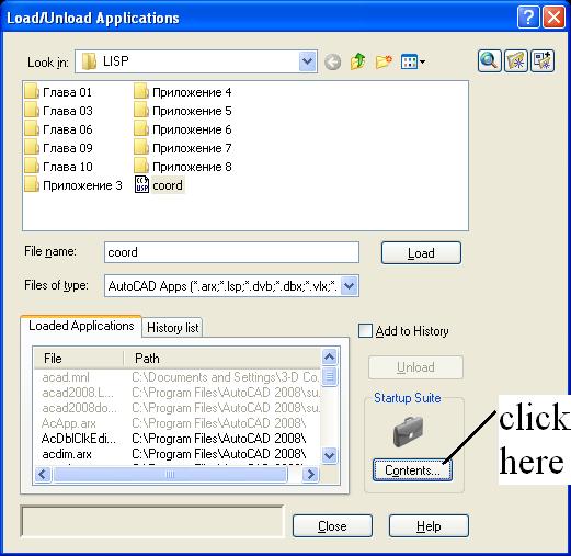

I am am new to using LISP files and was wondering how one gets certain ones to auto load every time you open ACAD?

Command APPLOAD then mouse over to LOAD find the lisp programs you wish to add then mouse over to contents and do the same.  One loads lisp's for just that session of CAD the other loads as a default.
Follow steps begining from this photo.
