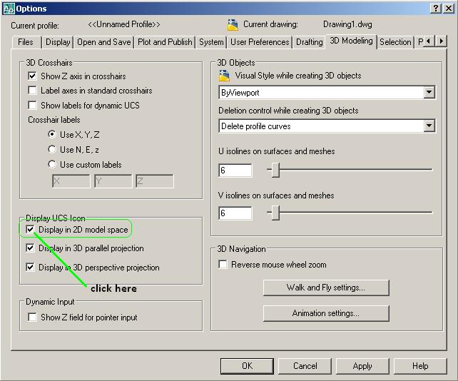

Ok you can change it by this image.

Direct Link To This Post Posted: 15.Jul.2009 at 13:07
Strange, I have no 3D modelling tab in my options dialogue o_O I am using Autocad 2006 version Z.54.10.
Ok for moment type :UCSICON-->OFF save as this drawing as template .
Start your work from this template file.
Maybe you need an AutoLISP file .
