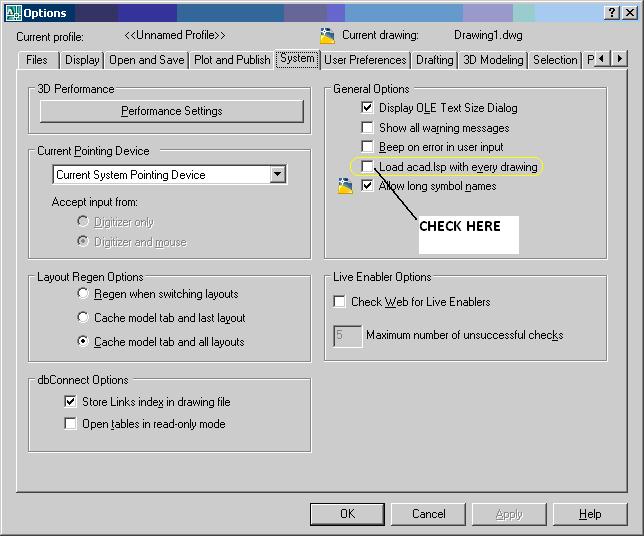

Maybe you need to stop loading acad.lsp.

Type appload and check for it in startup suite and unload.
