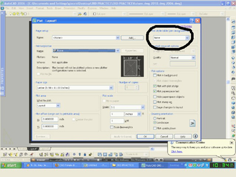

I have draw my design on the model space with color, but when i select layout and plot it. i notice the color doesn't show. kindly please guide how to show the color when plot to preview.

just print, and look plot style table then select your options either none,acad.ctb,grayscale,monochrome.....
I know you use monochrome or grayscale? in the plot style table.
