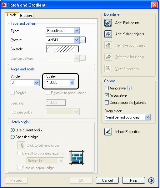

I do not normally work with AutoCad, but for a specific project I have been asked to do so.  While trying to put an ANSI31 hatch on a floor plan I continue to get a "Hatch spacing to dense or dash size to small" message when trying to install a hatch.  I have already set the "setenv  MaxHatch" to 10000000.  I have tried to bhatch on different layers as well.  Has anyone got any suggestions?

What  scale's  option  have you used under Hatch command?

I Have not a scales option under hatch command.  How would I do that?

When you type Hatch command do you see this image.?

Yes I see that screen, do I want to increase the number or decrease it?

If Autocad tells you the hatch spacing is too dense, you need to increase the scale factor.
