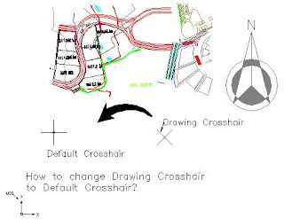

I am a beginner as a drafter..and just signed in to a company. I receive a drawing from a consultant company... Drawing is here:
Drawing from consultant came with crosshair as drawing crosshair above...
I want to change Drawing Crosshair to default crosshair...
How??

But all above answers not match to the drawing.
Any body can help me???
Please help and give me detail answer...

The crosshairs have nothing to do with UCS. Try changing your SNAPANG to 0.
Does that work?

 Or change snap style in 'Standard'
 Command:snap enter then choose S
