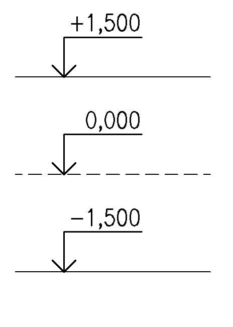

Dear users,
alfred and me prepare small package contains utility and dynamic block for spot heights. We would like share international version with you for free. Enjoy it.
Note: We aren't native english speakers and commets are welcome.
Please send us feedback or suggestions.
PepaR and alfred

Thanks for feedback, We are thinking about support for inches. Is it important for you?
Edited by PepaR - 11.Mar.2011 at 07:28

Support for imperial units would be very useful to me as 95% of the drawings I work on are done in those units.
For modification LISP I need know consuetudes for draving in inches. Mainly I need settings of DIMSCALE, UNITS, printing measure.
This is example of drawing in milimeters. Could you draw example in inches like this?
http://alfredcadpage.wz.cz/kotavysk/example-mm.dwg

I cannot speak for the entire CAD community in the U.S. I can only tell you what would be useful to me.
When setting elevations for slabs and floors we use decimal feet and inches.  For example 12" would be shown as 1.00' and 15" would be shown as 1.25'.  This is derived from the civil/surveying disciplines.
Architects would most likely use architectural units (feet, inches, and fraction of inches).  Examples: 1'-0", 1-3" and 1'-6 1/2".
Unfortunately most Americans never adapted to the metric system (although some segments have: scientific, medical, high-tech machining) so you'll find different variations of the imperial system amongst different disciplines.
I've been working in the architectural field for 7 years and spot elevations are always shown in decimal feet and inches. Since that's how the file comes in from the surveyor, there's no need to change to a different style of units. It would just confuse things if the existing grade was shown as 35.25 and then the proposed grade was shown as 36'-3 1/2". The contractor would be out there scratching his head trying to figure out the conversion from fractional to decimal or decimal to fractional in order to figure out how much to raise the grade.

Spot elevations, in civil engineering, are always called out in decimal feet and inches as Cad64 has mentioned.  BUT I have a set of architectural plans for an R&D building where the floor elevations are expressed in feet and inches using architectural units.
Maybe I have the wrong impression here when the lisp routine mentioned speaks of spot elevations.  Are we talking about those used in surveying or about elevations as they pertain to the height of a floor?

When I think of spot elevations, I think of a grading plan with finish grade, finish surface, top of wall, etc. That's always done in decimal units, same as the surveyors plan. An architects plan for his building might be a different story, but I've never seen a plan that used fractional units for elevations.

After reading the initial post that started this thread I guess I'm still confused.  It refers to "spot heights".  When someone uses the word "height" I immediately think of a building.  When someone says "elevation" I immediately think of a survey, perhaps a contour map or a site plan with "spot elevations".  The nuance of speech is sometimes our worst enemy especially when we start conversing around the world with our counterparts in England, Asia, central Europe, etc.
