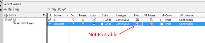

How do you eliminate the border (viewport line) when plotting a layout ? |

Work around with their layers . |

In your layer manager, just click on the little plotter icon for your
viewport layer. It should then display with a red slash through it to
represent that it will not plot.
