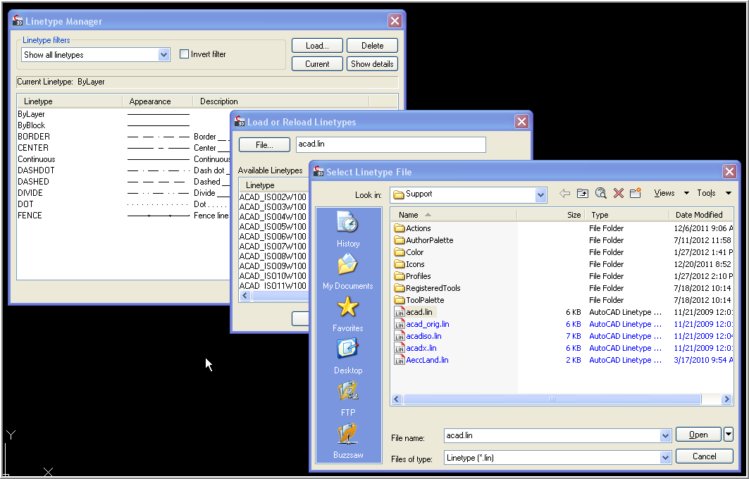

i try to load from the other option but dont found their respective folder.Any advice

Search on your system for the file: acad.lin ... it should be in your Autocad/Support folder.  And this folder needs to be in the Options > Files search path.

Very kind! now everything is OK.
