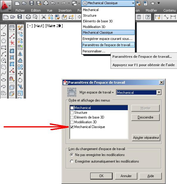

Hello Amien, see the image file ( if applicable to your AA 2011 ).

Hi Phillippe
Thanks for the reply. However, I am not using the mechanical CAD and therefore cannot do those changes.
