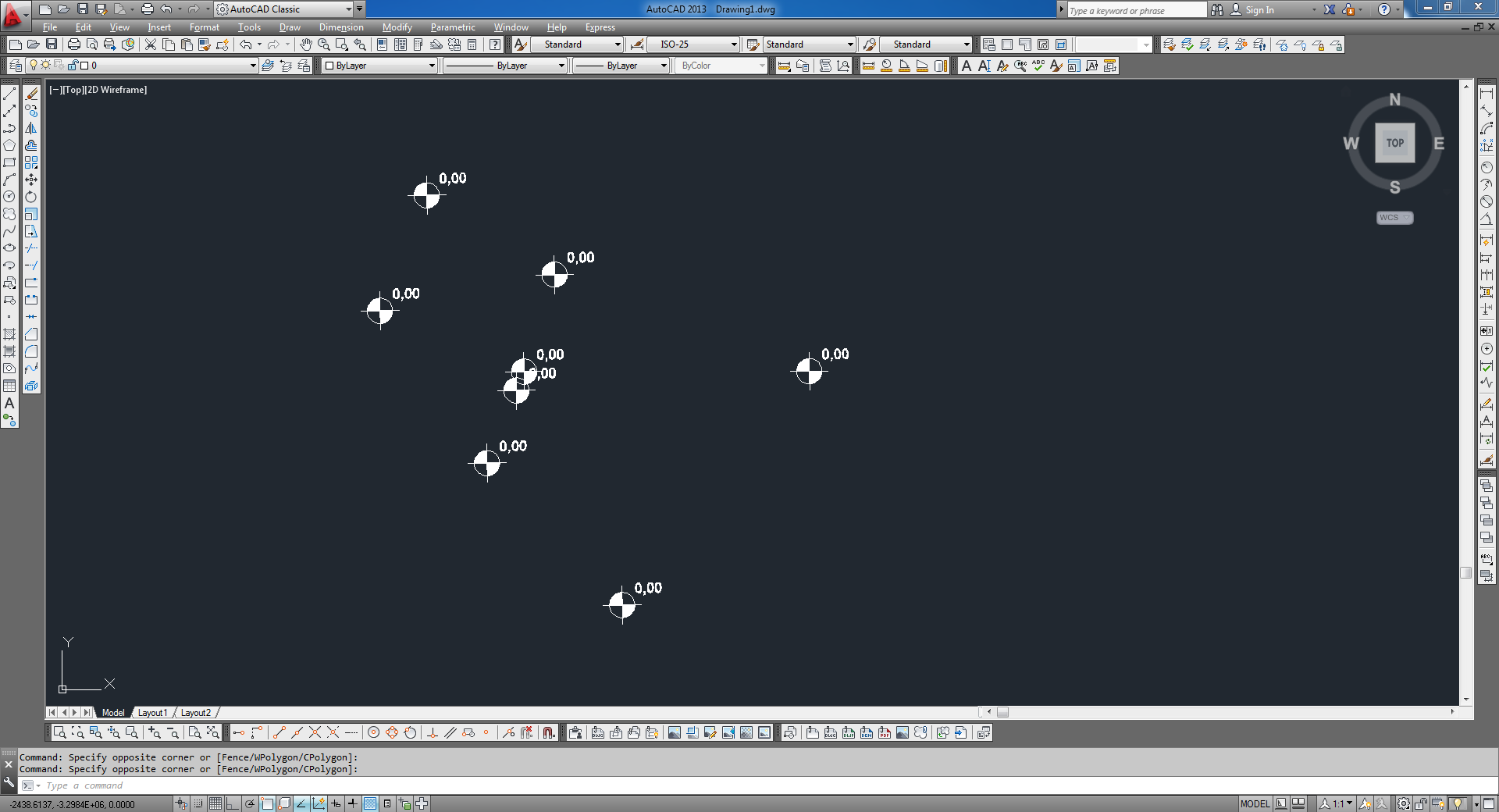

Direct Link To This Post Posted: 01.Mar.2013 at 09:02
I have tried it and it works well, however I can't get my attribute to show. It remains 0.00

Direct Link To This Post Posted: 25.Aug.2013 at 20:18
Vladimir,
Using the ASCPOINT.lisp
I have tried everything I can think of to get the attributes to come in but it's just not happening!!
XYZ no problem and it inserts the other points with a block at each one but does not update the attribute field???
I have a block with a sphere and one attdef with name pnum, noting in the prompt and 000-00 for the default and that is what gets put into all the attribute labels (it doesn't update them!!)
